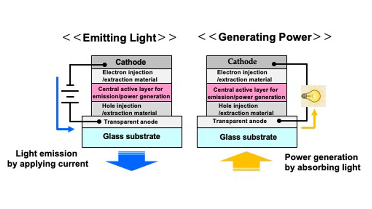

NHK’s Science & Technology Research Laboratories (STRL) says it has developed an organic light-emitting display element that can switch between emitting light and generating electricity, including blue emission – a key step for full-colour display applications.

In the Nature Communications study, the team outlines a strategy based on multiple-resonance thermally activated delayed fluorescence (MR-TADF) materials, paired with device-level control of charge-transfer states at donor/acceptor interfaces. The paper reports visible electroluminescence spanning blue through red, as well as white emission, while maintaining charge generation needed for photovoltaic operation.
Performance metrics highlighted in the paper point to progress on both sides of the trade-off. The authors report an external quantum efficiency (EQE) exceeding 8.5% for green and orange emitting devices, alongside a power conversion efficiency (PCE) of around 0.5% when operated for photovoltaic generation.

In practical terms, the concept is a screen element that can be driven to emit as a display, then alternate into a generation mode to recover some energy from light. The researchers also point to future “self-powered displays and lighting” as potential application areas if efficiencies and durability can be improved and the approach scaled beyond laboratory prototypes.
